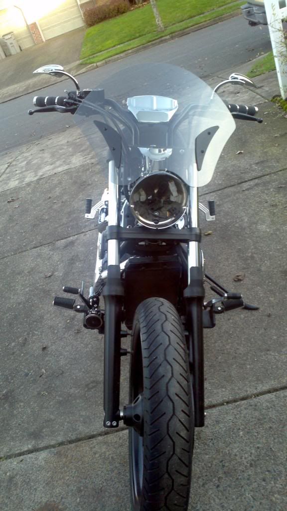

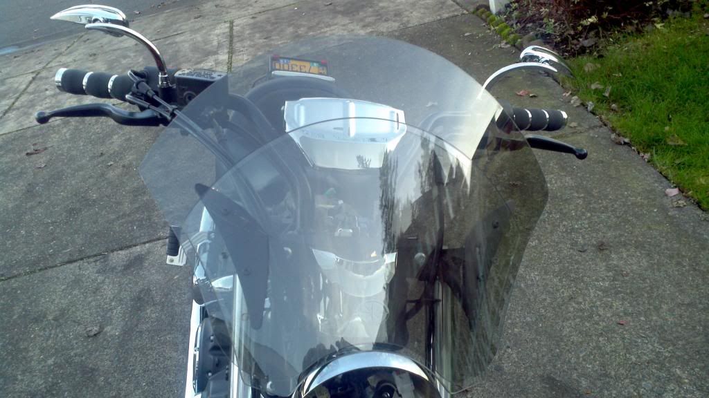

I made a supersized (14.5") version on my boulevard windshield that is slightly darker than stock.
Below I have the stock windshield on top of my new one for size comparison. Now if I can only get my parts back from my painter I can get my bike back together & see how the new windshield works......

Discussion Starter · #13 ·
midlifecrisis said:
How did you create the curvature?
To make my flat templet of the Boulevard windshield I traced it on cardboard pressing on one side & rolled it on the cardboard until the otherside was flat on the cardboard. That is how I got the proper location for the mounting holes. The new windshield flexes enough so I just installed it to get the curvature. Nothing special. I bought my Polycarbonate Sheet off of Amazon.
Discussion Starter · #14 ·
.... I think 3/16" or 1/4" might be better suited for this.
After getting a few hundred miles under my belt with the windshield I made I'm very happy with the wind deflection. Major improvement over that stock one. One change I would make is to go with 3/16" or even 1/4" (SmokenJoe was right) The 1/8" works fine but above 80mph the top does flex a bit.
