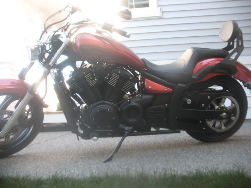

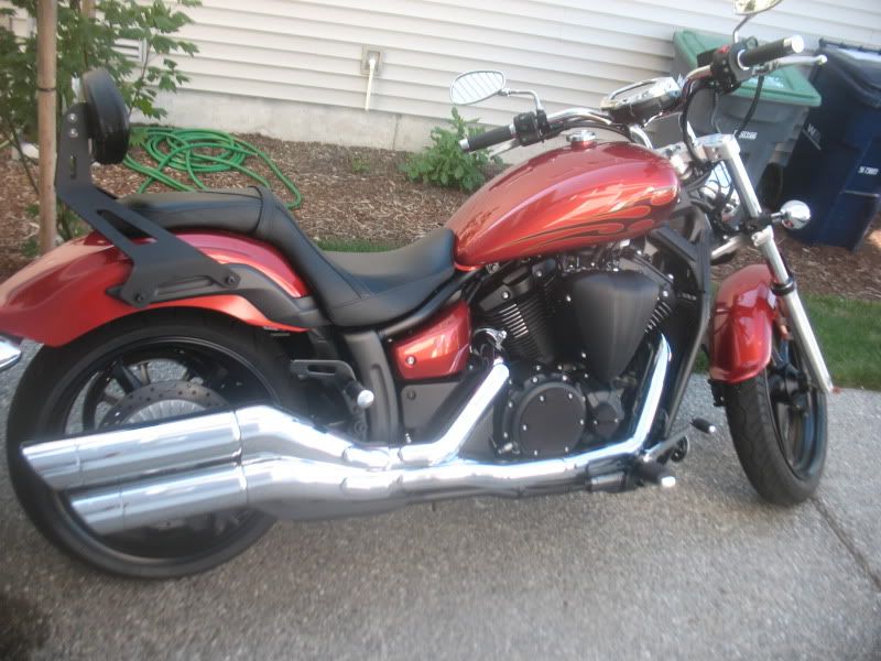

Installed the OEM backrest and painted all the engine plastics. I used automotive primer and flat black for everything except the clutch cover and the little piece that says Yamaha, for that I used semi-gloss black engine paint. It turned out a little brown/grey/powdery. Next I'm painting the headlight and everything else plastic on the tree, might as well do the blinkers while I'm at it.

Discussion Starter · #7 ·
I used 250 grit sandpaper to scruff up the plastic then sprayed it with engine degreaser. I did 2 coats of rustolium automotive primer and 4 coats of valspar flat black interior/exterior paint. It was an easy process, the hardest part was waiting for the paint to dry and avoiding drips. I have a few spots where if you look close you can see some dripping but it's not too bad. Overall I am happy with how it turned out.

Mine is great. Flexible plastic primer from napa, nothing special. 600 grit sandpaper, dry. Krylon black wrinkle out of a rattle can for the engine pieces. I used Duplicolor low gloss engine paint on the speedo and key trim. It doesnt have to be engine paint, it happens to have a matte finish which is what I was after.
2,000 miles on this and it still looks good. I ride in the rain too, not one prob.
