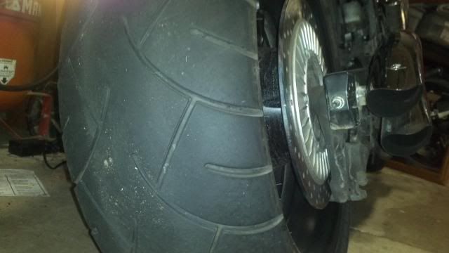

I have 5k miles on my 240 Metzler 880 rear tire & shows very little wear. With the 240 rear tire it does take a little more effort when leaning in the curves but the handling is way better. The taller tire also gives you more peg clearance.
Here's a pic I took this morning. Less than 1K of the 5K miles on this tire are hwy.

Thanks for the pic and info - is that the stock rim? I read various times some owners stating that they need to shave some off here or there due to scraping, others saying nothing scrapes.
The only places you need to be aware of are the lower belt guard and the rub tabs under the fender on the frame that come to a point. With a stock suspension setup/ not lowered and proper pre-load adjustment, you wont have any problems solo riding but 2 up packed you may bottom out hitting extreme dips and potholes.
I raised mine up to the one" lowering point and set the pre-load at #2, 2 up riding and being carefull over potholes had no bottoming out issues. . I did grind the rub tabs off and put a notch in the lower belt guard were the tier rubbed,
My Son has the Avon 240 on stock rim, lowered 1" and has never even come close to bottoming out. I had that same 240 on my stock rim at one time with the L&M 1-1/2" lowering spring- 2 up with bags and never bottomed out. I don't believe it is possible unless you lower to 2-1/4".
