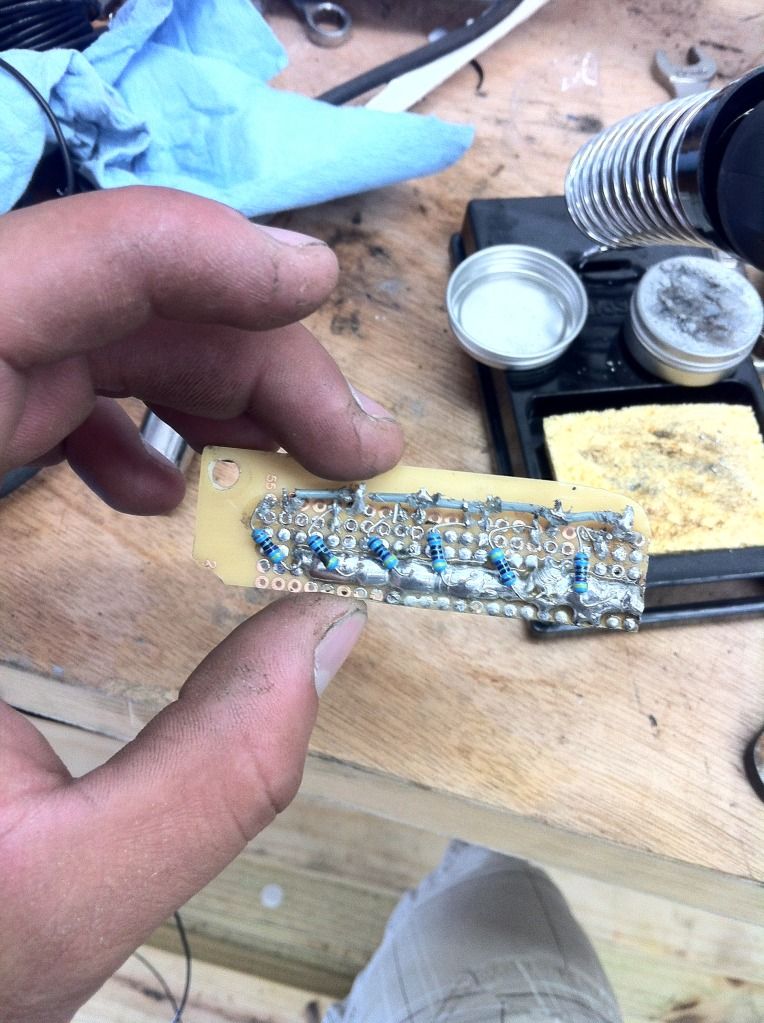

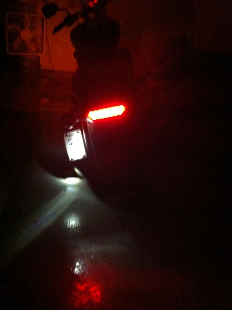

License plate LED light bar
Spent like 15 bucks on parts. The light bar is tucked under the fender and I used some jumbo narrow-beam LEDs so I could aim the light all the way from where the LEDs are hidden. Brightens up the license plate extremely well at night, almost too well......

Nice!!! Any reason in particular you wired the LEDs in parallel? You could have used half the resistors if you went in series. But of course, all that would save you was about 30 cents LOL
