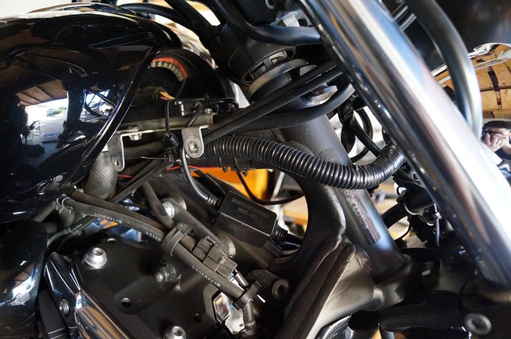

Real easy install guys n gals.... This is an H4 5K(white) H.I.D. Kit that i decided to install for night rides and works real well!!!
This is the only way you can install it to your Stryker without having to splice into the wire harness and voiding the warranty.
Just insert the cable into the hole of your headlight bucket and connect the "2" prong connector to your factory harness
Obviously you have to remove the plastic pieces on both sides of the bike.
I used zip ties for now to hold the black square piece in place thats above the frame of the bike
Cable with rectangular piece goes around and under the right side of the bar and left side remains where its at
Connect them together to the H4 bulb harness and put back plastic covers on both sides of bike and your done!!!
Took less than 5 min to do, Im planning on buying some 1" shrink tube to cover the wire better and so it somewhat
weather proofs it???

so my bulb that i got with my kit only has 2 wires to plug into the factory relay in the headlight housing, any thoughts bc my main light isn't coming on. Thinking that the on board computer might think there isn't a bulb in there since it pulls so low, but i ahve no clue
918 Posts
Make sure your drawing your power from the low beam lead wire. There are 3 wires for the headlight ground/low or constant and then high beam. Hope this helps
