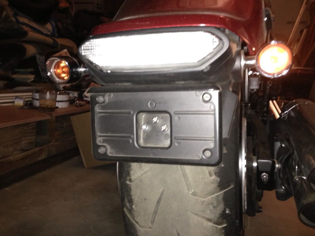

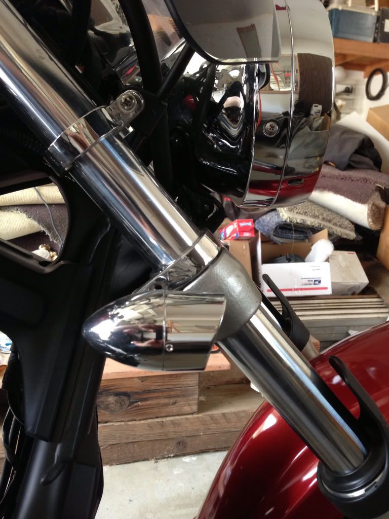

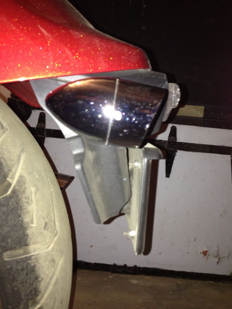

I've had the bike six weeks and already done a fair amount. Still no license plate...
- removed stickers and badges first or second night
- hacksawed the rear sub fender, put in black lay-down license bracket, LED frame, and show chrome bullet marker lights for rear signals. The signals aren't made anymore (salvaged them off my crashed vstar 1100 - ignore the dust, I live on a dirt road):
