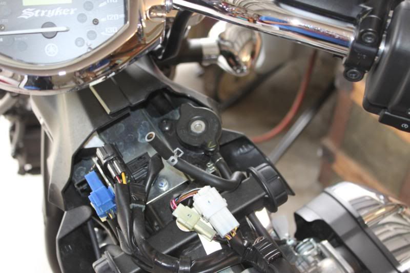

To remove the Gas Tank you will need to remove 2 bolts and disattatch 3 Hoses and 1 Connector
Tools Required:
Socket Wrench
12mm Socket
Pliers
First make sure your gas tank is empty.
Then disattatch the hose on the left side. use a set of pliers to get the clamp off.
Then remove the 2 bolts (1 per side)
Slide the gas tank back (towards the tail) to unhook the tank from the front slots.
Once the tank is lifted about 4 inches you can unplug the elctrical connector,
And disconnect the hose from the back center of the tank and from the front right part of the tank.

If you're talking about the 8th picture, that's the fuel petcock.
As for draining the tank, you can buy a manual pump at your local auto store for under $10 and siphon it out
looks like you can twist that knob on it to shut off the fuel so then the gas in it wont come out.. just wouldn't flip it upside down

I assume this is the bolt we are to be mindfull of?
Correct.
For whoever asked, the valve is a petcock. It shuts the fuel line off.
