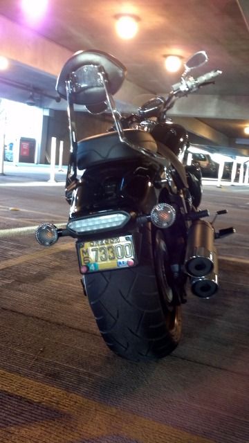

Here's a rear shot with my 240 tire that I installed reciently. Love the extra peg clearance the taller tire gives. Now I don't scrap the pegs all the time. Still get a few scraps every ride but I do enjoy the twisties.

You said the thicker back tire also make the big sit up higher? Is that why their is more peg clearance, and does it make your bike look or ride different being as the rear is higher up? Or not enough to notice
The 240 is a bit more tire to throw around but I like the ride beter than the stock 210 rear tire. The taller tire does give a bit more peg clearance & the prime reason I upgraded before the stock rear tire was hardly even broke in. Sorry for the late response, this one slipped by me.
