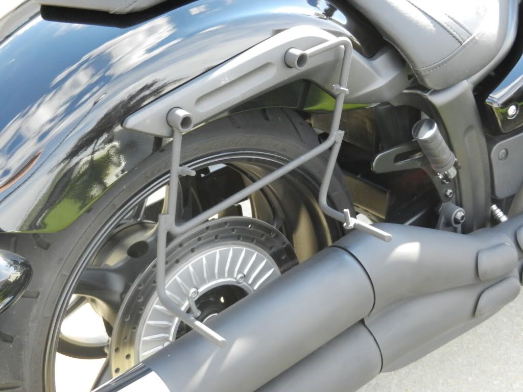

Here are some pictures of the bag mounts I built, and the grips that I installed. I used 5/8" steel, slightly less than 8' in length. I tig welded some schedule 80 pipe nipples that were used for where the bolts to the fender go. I believe these are #8 125mm. I used 1/4" 20 screws to fasten the bags to the bracket and fender washers.
The grips I show how to take the chrome of the throttle tube.
To pull the end weights off, you have to remove the tiny caps in the center of the weight when looking at it from either side. Under the cap you'll find a metric allen head, I don't remember the size, but they are pretty easy to remove. Once those were off, I used a small screwdriver to mover around the clutch bar, and the throttle side I disassembled.
