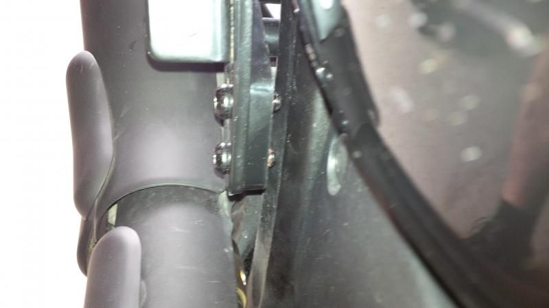

Hey, This may have been covered a couple of times but just wanted to share the info with pics in one place. if your wanting to get your passenger some more room (besides buying them their own bike :tongue:) you can lower the pegs and push them forward a few inches. I used a set of peg extensions from extension depot for a vstar 650, the only thing i would recommend changing out is the longer bolts, they werent long enough to reach all the way through the frame mount and spacer provided. the bolt size is m8x1.25x50mm i used and will reach through the frame mount and remember the locktite also..hope this helps you guys out.

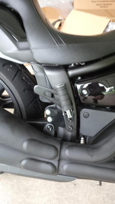

They will definitely work with stock or Slip-On exhausts, but from what I can see, these probably wouldn't work with the Swept or Big Radius exhaust systems. They might work with the Twin Slash system.

Great pictures, shows exactly why they won't fit. Here is a picture of mine with the relocation brackets I made on. It moves them lower and forward.

Here's a decent pic looking down and towards the rear. It's a little closer than I was guessing with the bolts through the mount. They don't flex any from what it seems so no scratching the frame that I'm worried about just yet.
