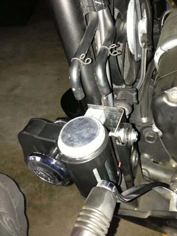

Aight guys n gals need help with a MOD..... I installed a Wolo Air Horn on my bike and placed it in the location of the CA Emissions Canister
Need to know what to do with these tubes befor i go on a test run rite now...... Help ASAP!!!

Not from CA but from what I've seen it just runs through the canister so go to Home Depot etc. and look for something in the plumbing/irrigation section that will connect the 2 tubes like a "U" shaped deal. Couple of hose clamps or electrical tie downs and I think you'll be fine. I never saw electronics there so removing the part and putting in the bypass loop should be fine...
404 Posts
One of the tubes goes to the throttle body via under the tank. I pulled the whole thing out and capped it with a cap I found at autozone. They sell assortments for capping/plugging vacuum lines. It needs to be plugged because it'll act like an intake leak if its left open, methinks.
The other one is the tank vent, which needs to be left open. Mine I just left where it is.
