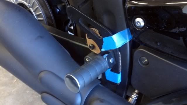

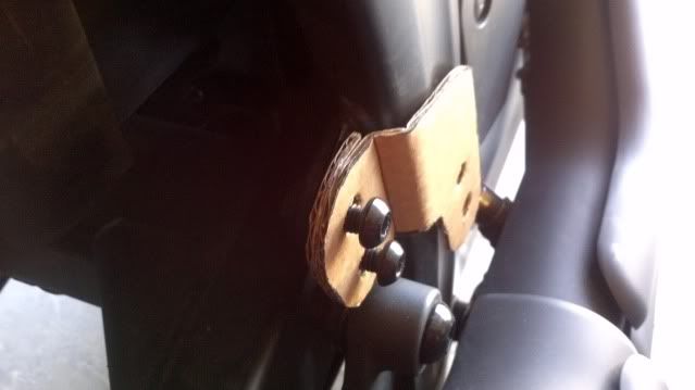

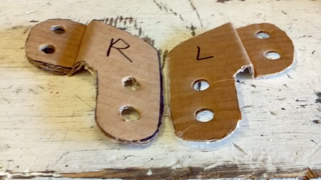

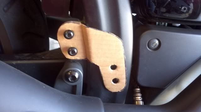

I'm planning on relocating the rear pegs on my Stryker for my long legged wife. Here's what I came up with yesterday. Actual bracket will probably be made from 1/4" steel, the front holes will be treaded/nuts welded to backside & rubber stoppers on the backside so no metal to metal rubbing.
Life keeps me busy but I'm hoping to have these completed in the next couple weeks.
Stock
Relocated

The Warrior relocation brackets are nice but my wife likes to lean against the wings(protectors) on the stock rear peg assembly.
Time will tell what I end up with....... I going check with some local machine shops to see what they would charge to make these, 1/4" steel is not easy to play with without the right tools.
