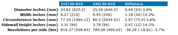

The other guys plate was hanging below the stock light if I recall. Yours might have come lose. But you are pushing the load limit at 450 lbs and lowered any will make it even more of a risk. But I'm not so sure the tire could catch the end of the fender and tail light bottoming out with a stock 210 tire? I packed my saddlebags and strapped a duffel bag to the back bar and put the wife on the back total maybe 425 lbs and rode to Frisco and back. Stock everything except the preload was set to #1 because it was too stiff for solo riding and we bottomed out a few times but the tire only rubbed up near the highest point of the fender and where the duckbill and tail light mounts to the fender. Don't think the 210 is big enough to reach the back of the fender. Had the wife on the back with only saddlebags packed estimate less than 400 lbs with lowered 2.25 and 240 rear tire and preload set at #7 bottomed out several times, twice at 65+ and no signs of the tire hitting the tail light. I cut the duck bill off just under the light and have a side mount plate.

If you put a 240 on you will need the PCS progressive spring and set your preload to at lest #7 and maybe even set your links at the 1" slot if you are going 2 up and max load limit. If you don't I guaranty you will gouge chunks out of your tire with the rub indicators that are pointed under your fender.
