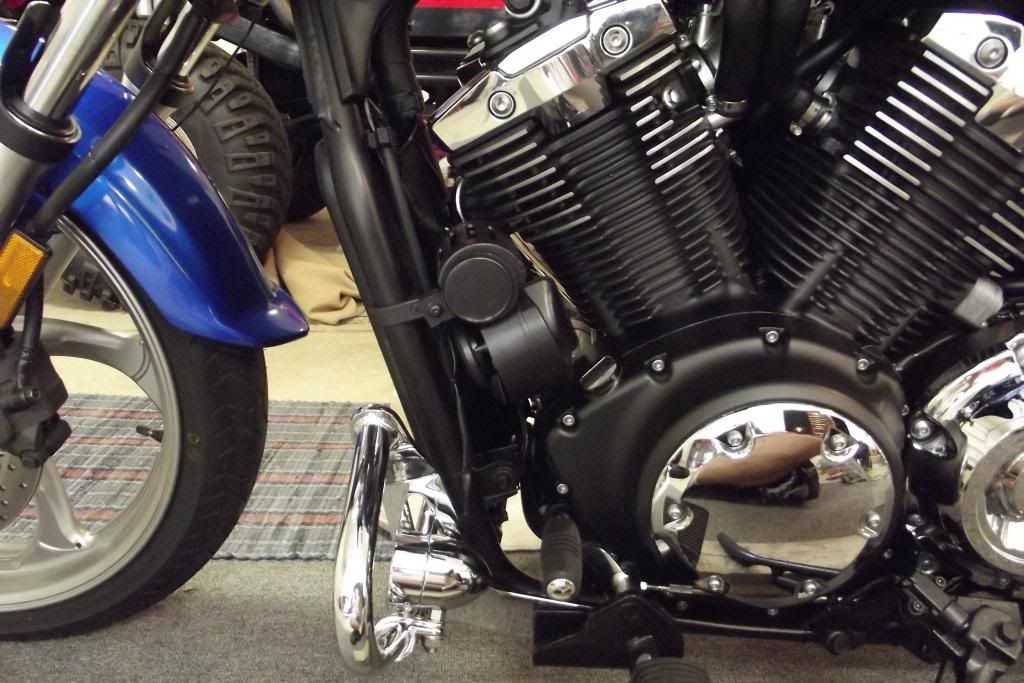

Yep....I have the WOLO Big Bad Max. It took me FOREVER to find a good spot. I finally mounted a P clamp on the left side radiator down tube and mounted the horn behind the radiator to the P clamp. I ran a bolt through the P clamp through the tab on the horn. It says not to mount horizontal, but I did anyway. I don't have pics, but picture mounting it with the air canister on the top, horn part on bottom, electrical connections facing in. Just high enough to get the oil cap off the motor. Hope that makes sense.
And I used the wiring harness that skwerlee just posted.
Thank you for the response..I was starting to think this site had died off....Actually, your description is very easy to envision! Have you run into any problems as far as performance, functionality, and/or heat resistance in that location? My bike gets plenty hot for this plastic cover they have on this horn....

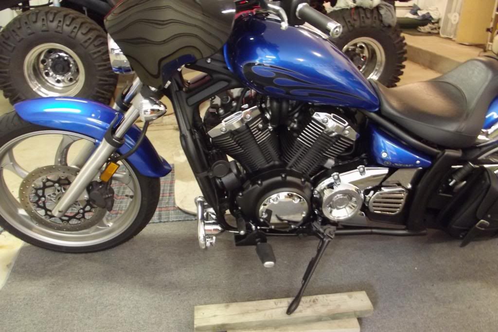

Mounted my new wolo right above the radiator. Saw someone else on here did the same and decided to copy.
Thanks for the tip...Can you link me to the pics (if there were any)?
Knock on wood...no issues here!
Added them to my first post.
Man, That's sweet! Thanks for breaking out the camera on that one! I probably would have never thought of it. I just have to see if this Stebel will fit either in your configuration or in the config that Sledhead suggested. I gotta do something. Friggin MD state inspection trying to hold me hostage. I agree the stock horn was garbage to begin with, but my bike has passed inspection just fine in multiple states and even Guam.....I appreciate that assist all!

Just rechecked my previous orders with Cruiser Customizing and KY-4023 is exactly the P-Clamp I used to attach to the radiator down tube.

I used P clamps around the frame on the right side, and used stock horn wires. Definitely DO NOT install it without the wiring harness or relay switch. I've installed 3 of these on every bike.
